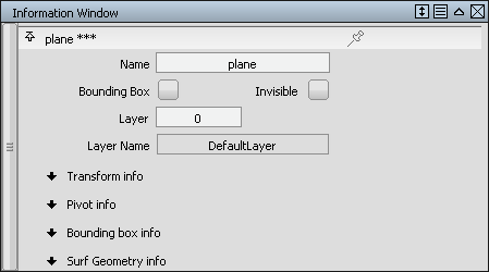

View and edit object properties
Edit information about an object
  1. Choose Windows > Information > Information Window.
  2. The information window opens, showing information about the picked objects:
    Checkboxes can be set and unset to change the visualization of data. Information in white cells can be edited.
What if...?
I want to keep information about an object visible in the information window even when the object isn’t picked?
Pick the object, then click the icon next to the name of the object.
The object will be shown in the information window whether or not it is picked. To get rid of the information, click the icon again.
