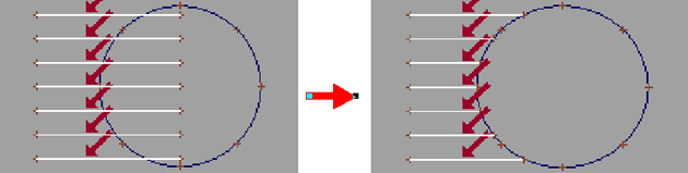

Slice a group of curves at their intersections with a sectioning curve or surface
- Choose Curve Edit > Curve Section
- Do one of the following:
- To trim the curves, set the Sectioning Mode to Trim.
- To detach the curves, set the Sectioning Mode to Segment.
- To insert edit points on the curves, set the Sectioning Mode to Slice and the Slice Creation Mode to Insert Edit Points.
- To create a new curve that passes through the intersections, set the Sectioning Mode to Slice and the Slice Creation Mode to Create Curve.
- Set the Sectioning Criterion to Geometry, then click Go.
- Pick the curves or curves-on-surface you want to trim, in the view window where the curves and the sectioning curve/surface intersect.
For trims, click the part of the curve you want to keep. Red arrows show the “kept” part of the curve.
- Click Go.
- Click the curve, surface, or construction plane that you want to section with.
