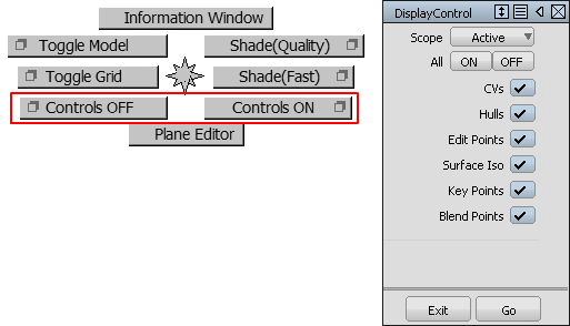

Controls on and off

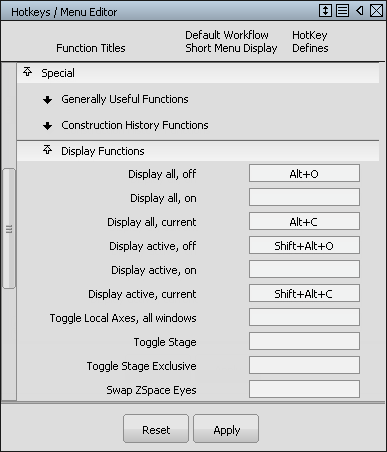

Turning on the display of control points is something you will do hundreds of times a day, and so it is particularly useful to set up a hot key.
To set this up, use PreferencesInterfaceHotkeys/Menu Editor.
Near the bottom of the option window, there is a Special... Display Functions section. This lists settings available in the Object DisplayControl window.
Alternatively, set up the marking menus with the Object DisplayControl settings.
