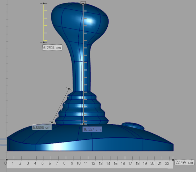

  1. Choose Evaluate > Dynamic Measurement.
  2. Click anywhere in an orthographic or perspective window to define the first point. Hold down the mouse button and drag to move the point around.
    A cross-hair appears.
  3. Click somewhere else in the same window to define the second point. Hold down the mouse button and drag to move the point around.
    A ruler appears between the two points and the distance between the points is displayed (in the current linear units).
    Note:
    Click with the middle or right mouse button, to align the second point horizontally or vertically (respectively) with the first point.
  4. Repeat the steps above to create another measurement in the same window or another orthographic window.
    Note:
    The measurements are not persistent and disappear as soon as you select another tool.
To modify the start and end points of a dynamic measurement
  1. Roll the mouse over the start or end point.
    The point turns yellow.
  2. Click and drag the point to another position. The middle and right mouse buttons move the point horizontally and vertically respectively.
To move the measurement
  1. Roll the mouse over the ruler.
    The ruler turns yellow.
  2. Click and drag to translate the ruler. The middle and right mouse buttons move the ruler horizontally and vertically respectively.
To anchor a measurement
  1. Move the ruler so the start point is on top of a wireframe, shaded object, or locator.
    The start point turns into a square to indicate that it is attached to the object. The ruler becomes lavender and remains parallel to the view plane.
  2. To free the measurement from the object, just move the start point off it.
A measurement can be anchored in any view, including the Perspective view.
To remove all measurements
    All measurements disappear as soon as you choose another tool. However, if you need to remove them while still in the Dynamic Measurement tool, press the Clear button at the bottom of the window.
