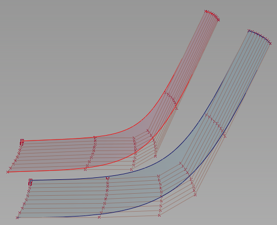

In the example below, the top surface is offset by 10.0 units from the bottom surface, using the Off mode (first image), then the NUV mode (second image).
Normal Mode = Off: optimal accuracy but CVs form a bow tie.
Normal Mode = NUV: better CV distribution but slightly less accurate offset.
