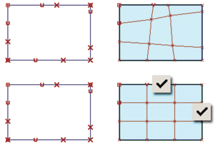

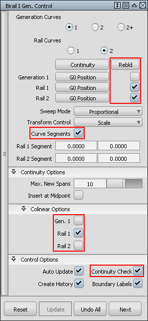

Rebuild
The Rebuild 'ticks' can help to improve the parameterization of edges, particularly when building from trimmed edges, or when opposite edges have different parameterization. Use with Explicit Control to get the best CV layout.
