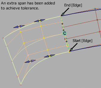

You must select your tolerance settings in the Construction Options window before you start to model.
Alias will then use these values as a goal to align two surfaces. If it can't achieve the required tolerance with the number of CVs available, it may increase the degree or the number of spans.
