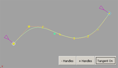

Stretch a curve so it touches another curve
  1. Choose Curve Edit > Modify > Stretch.
  2. Select the curve you want to stretch
    Two control handles appear at the ends of the curve.
  3. Click on the handle you want to touch to the other curve.
    The handle turns white.
  4. Hold and (Windows) or and (Mac) to turn on curve snapping.
  5. Click on the other curve to snap the handle to it.
  6. Drag the handle along the curve.
How do I use the curve stretch handles?
How do I use the tangent manipulator?

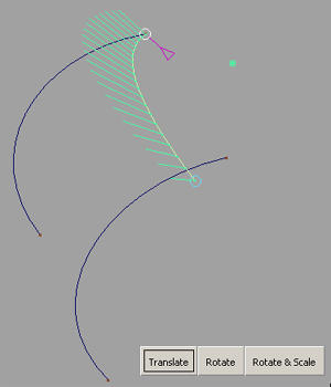

  3. Click on the Translate button in the window.
  4. Select the control handle closest to the first rail.
    The selected handle turns white.
  5. Turn on Curve snap mode by holding down the and (Windows) or and (Mac) keys (or Magnet mode by holding down (Windows) or (Mac) only).
  6. Click on the first rail curve. Drag to change the position of the intersection.
    The input curve is translated so that the first control handle intersects the first rail.

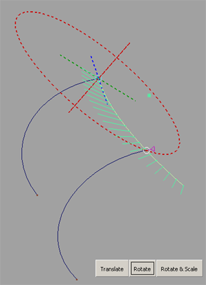

  7. Click on the Rotate button in the window.
    The second control handle turns white. A manipulator appears at the location of the first control handle. This can be used to specify the plane of rotation: XY, YZ, XZ. By default, the curve rotates in its own plane.
  8. Turn on Curve snap mode by holding down the and (Windows) or and (Mac) keys.
  9. Click on the second rail curve.
    The input curve rotates in the specified plane of rotation, using the first intersection as its rotation pivot, so that it now intersects the second rail.

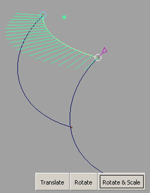

  3. Click on the Rotate & Scale button in the window.
  4. Click on one control handle.
  6. Click on the rail curve you want to snap the selected handle to.

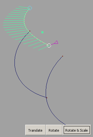

  7. Repeat steps 4 to 6 with the other control handle.
    The input curve is scaled so that both control handles make contact with the target points on the rail curves.
    The curve is modified, but the general shape characteristics are maintained, as can be verified by using a curvature comb on the curve (Locators > Curve Curvature).
