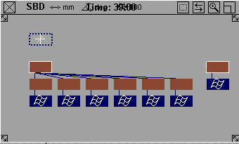

- Turntable animation is applied at the root node (the top level in the SBD window). If you attempt to create turntable animation using other than root nodes, the following error message appears:
Only root level objects can be turned. Turntable stopped.
This could happen if you select the objects to animate by picking them directly from the SBD window. Use Pick > Object
instead to select the objects you want to turntable.
