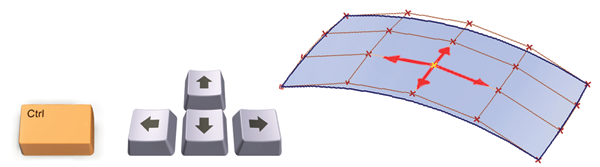

Pick Walk
If you have one CV selected, or one Hull, the pick walk lets you step along to the next CV or Hull without leaving the tool you are using. Hold down the Ctrl key and use the keyboard arrow keys.
