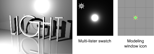

Render > Create Lights > Point
Creates a point light that illuminates evenly in all directions.
Point lights are like incandescent light bulbs — they throw light evenly in all directions.
