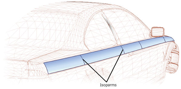

Multi-span surfaces are used mostly for quick or concept modeling, where the requirement to create the geometry quickly outweighs the need for surface quality.
The quality limitations of multi-span curves and surfaces are at the segment boundaries between spans, shown by isoparms on a surface and edit points on a curve. In these two examples of a degree 3 curve, the first is a single-span curve and has edit points only at each end. The curvature plot is smooth.
