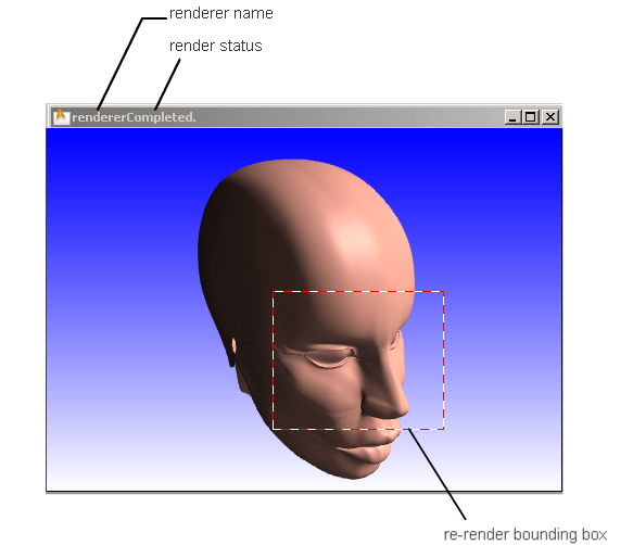

Render > Direct Render
Renders the active window directly on-screen.
Direct Render window
