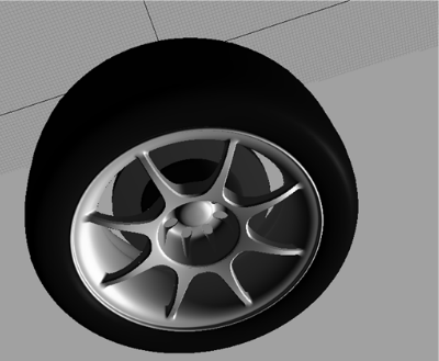

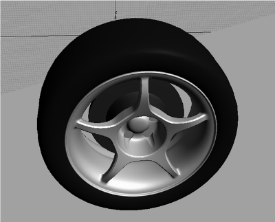

To create an eight-spoked wheel by rotationally scaling a spoke of a five-spoked wheel:
To make these copies, use Edit > Duplicate > Object
. In this example, the wheel was in the X - Z plane, so the rotation is about the Y axis. Set the following options in the Duplicate Object Options window:
A new wheel is created, with eight spokes:
