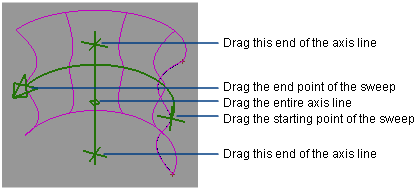

How do I use the revolve manipulator?
- Drag the handles to move them in the view window.
- Click a handle, then drag the mouse left or right to change the value.
- Click any of the handles and type exact values.
