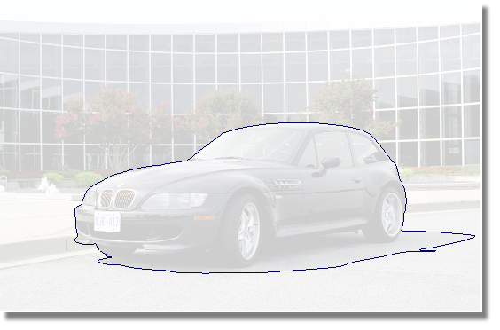

  1. Choose Layouts > Top to maximize the Top view.
  2. Choose Windows > Editors > Canvas Layer Editor to open the Canvas Layer Editor window.
  3. In the Canvas Layer Editor window, double-click the bmw value, type 0.2 and press (Windows) or (Mac).
    Now you can better see the curves.

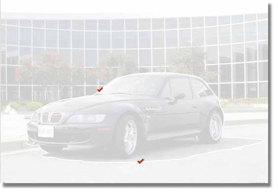

  4. Choose Paint > Shape > Make Mask Shape to select the Make Mask Shape tool and open the Shape Edit window.
  5. Change the Fill value to Inside.
  6. Click both curves.
    Each curve should become highlighted in white and have a check mark on it.

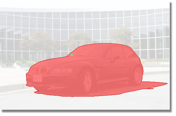

  7. Click Accept to create a mask using the highlighted curves.
    Masked regions are shown in red.

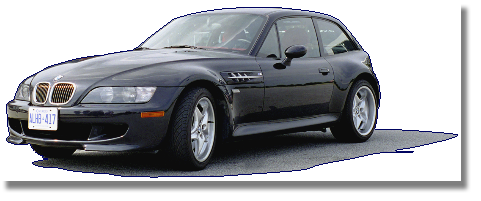

  11. In the Canvas Layer Editor window, double-click the bmw layer’s value, type 1 and press (Windows) or (Mac).
  12. Make sure the bmw layer is active. It should be highlighted in purple. If it is not, click it.
  13. In the Canvas Layer Editor, click the button, or choose Edit > Clear layer to erase all unmasked regions.
