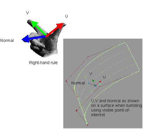

Normals are imaginary lines perpendicular to each point on a curve or surface.
The direction of U and V isoparms on a surface determines the direction of the surface normals, according to the right-hand rule. This rule states that if the thumb of your right hand points along U, and the forefinger along V, then your middle finger, bent at a right angle from the first two, points along the surface normal.
Normals are an indirect indicator of the shape of a curve or surface. Since they are always perpendicular to the curve or surface, the way normal lines point toward or away from each other can reveal subtle curvature.

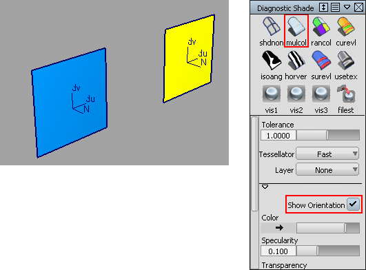

The Multi-Color mode of Diagnostic Shading uses blue and yellow colors to show the surface orientation when the Show Orientation option is turned on. Blue means that the front of the surface is facing the viewer. Yellow means that the back of the surface is facing the viewer. Once again, this orientation is independent from U, V, and surface normal, as shown in the following image.
