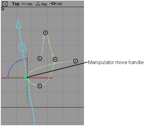

Lets you edit the direction and continuity of a blend point.
The Blend Curve Edit tool has a manipulator allowing you to move individual Blend Points in your curve and modify their tangent. This manipulator has a move handle, at the center of the point, which can be dragged into a new position, as well as other handles that let you adjust the tangent length and direction.
