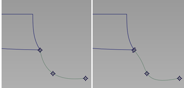

Auto Align at Surface Corners
When this option is checked on (default), a blend curve that is snapped to the corner of a surface (or trim surface) is automatically aligned with tangent continuity to one of the edges (or trim edges).
Auto Align at Surface Corner OFF (left) and ON (right).
