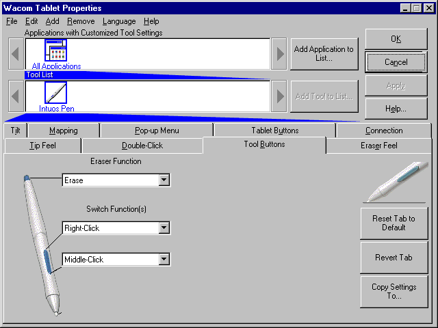

  1. From the Windows Start button, choose Start > Programs > Wacom Tablet > Wacom Tablet to open the Wacom Tablet Properties window.
  2. Click the Tool Buttons tab.
  3. Set the Switch Function(s) to Right-Click and Middle-Click.
  4. Click OK to close the Wacom Tablet Properties window.
