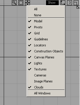

Show or hide different items (geometry, lights, grid, and so on) on a per-window basis.
This is the easiest and quickest way to change the visibility of items in a single window.
A menu is displayed.
Hold down the
key to toggle several items without closing the menu. Click outside the menu to close it.
This method works for the current window or all windows.
The settings take effect if the item type chosen is currently visible. If the item is turned off on an object basis (for example, by using one of the ObjectDisplay menu items), it remains off regardless of the choice made in the Show option box.
The individual tools are still available from the WindowDisplay > Toggles menu to make it easier to add the different display toggles to shelves.
Animation items (such as skeletons and IK handles) can be toggled from the Animation > Show menu.
