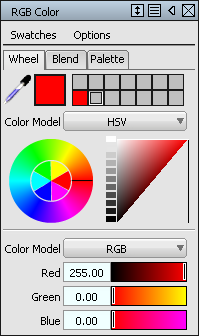

  3. In the Shader Parameters options, click the rectangular color swatch located under RGB Color and next to the color slider.
    This opens the color palette where you can choose a different color for the shader.
  4. Change the color by clicking the color wheel. You can modify the color’s intensity in the HSV triangle.
  5. Close the window when you’ve got a new color selected.
  6. Click the Assign Current Shader icon. The color updates on the picked surface.
