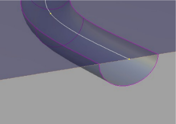

With the Tube option, the resulting geometry is a full tube. Using the Groove option results in the part of the tube on either side of the surfaces which the tube intersects. Choose None to create no geometry.
Radius
Defines the radius of the tube. Create a variable radius interactively by adding more radius manipulators along the curve. Adjust the radius of the tube interactively by dragging its manipulator.
This image shows a surface created by using the Tubular Offset tool with Groove option. Notice the top surface can be trimmed to reveal the groove. This option is useful for representing parting or cut lines.

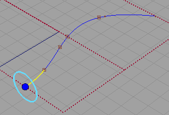

Controlling manipulators in Tubular Offset
Each manipulator consists of two handles — the rail slider and the radius handle — only one of which can be active at a given time. The active handle is shown in light blue. The rail slider, a "ball" sliding along the rail, indicates the position on the rail where the radius applies. The radius handle, an approximate cross section of the future surface, controls the radius at this point.
The value of the active handle is shown on the status line.
For all of the following operations, use the , unless stated otherwise.
