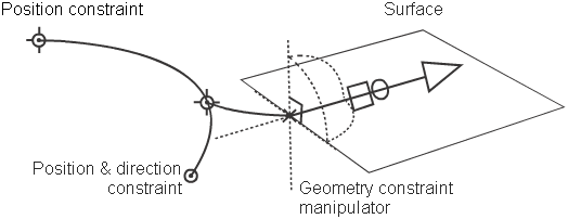

Blend curves are controlled by blend points acting as constraints:
You create the curve by setting up the constraints, such as
...and so on. Alias draws the curve to satisfy the constraints, and automatically updates the curve when the constraints, or the objects the curve is constrained to, change.
