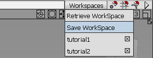

Save a window configuration as a workspace
  1. Position and resize your windows the way you like.
  2. Choose Save WorkSpace from the Workspaces menu to the right of the prompt line.
  3. Type a name for the file in the File name field and click Save.
    The workspace is saved in the default location under your UserPrefs2014 folder. The workspace name appears at the bottom of the Workspaces menu.
Retrieve a workspace
  1. Do one of the following:
    • Select the workspace from the Workspaces menu.
    • Choose Retrieve WorkSpace from the Workspaces menu, select the workspace configuration file, and click Open.
    The name of the retrieved workspace appears on the Workspaces menu button.
Delete a workspace
In the Workspaces menu, scroll down to the small delete icon next to the workspace name until it turns red, then release the mouse button.
