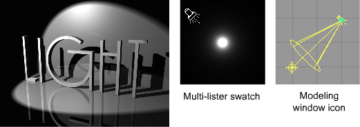

Render > Create Lights > Spot
Creates a spot light that illuminates in one direction in an expanding cone.
Spot lights cast light in one direction only, emanating from a point in an expanding cone.

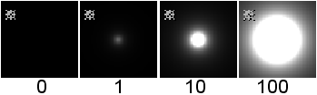

Intensity
The brightness of the light. If the light exerts a force, this value sets its strength. A light with an Intensity value of 0 produces no light. A light with negative Intensity value removes light from a scene in the area of the light’s influence. The slider range is 0 to 100. The default value is 1.
Tip:
Use a negative Intensity value to reduce or remove hot-spots or glare.

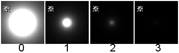

Decay
Controls how quickly light intensity decreases with distance. The Decay setting has no effect at distances less than 1 unit. If Force is set (that is, not OFF) under Active Effects, the Decay value controls how quickly the force intensity decreases with distance.
Valid settings are 0, 1, 2 or 3. The default setting is 1.
0 no decay; light reaches everything
1 light intensity decreases directly (linearly) with distance (slower than real world light)
2 light intensity decreases proportionally with the square of distance (the same as real world light)
3 light intensity decreases proportionally with the cube of distance (faster than real world light)
