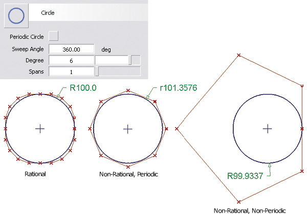

With the circle tool, the result you get depends on your choice of Rational Flag, but also on your choice of Periodic geometry set in the Circle tool option window.
Only rational circles are true circles with the same radius at every point along their circumference.
