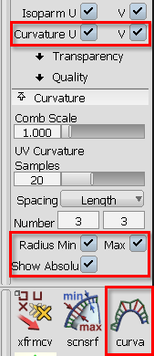

The Curvature tool in the control panel has a new option called Show Absolute. Check it on to see only the absolute minimum and maximum radii over all the curvature plots in U and/or V.

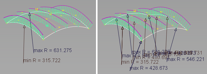

To see the absolute minimum and maximum radius:
Left: Show Absolute = ON; Right: Show Absolute = OFF
