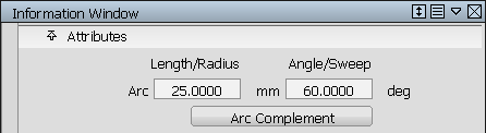

Keypoint Curves are CAD-like drafting curves, creating accurate geometric shapes — in particular, exact arcs and circles. First create the curve in the modeling window. Then, with the curve selected, use WindowsInformationInformation Window to type in the dimensions required.
