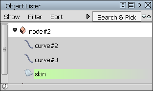

Curves or surfaces can be grouped together to form a new node, which can be given a name, and selected as one object. This can be used in the same way that you group curve segments into curves in ICEM. The main difference is that a group can contain a mix of different entities.
Like ICEM, Alias doesn't create assemblies, instead, the EditGroup tool can be used to simulate a structure of parts.
To select entities within a group, use PickComponent, or EditUngroup to return to independent entities.
