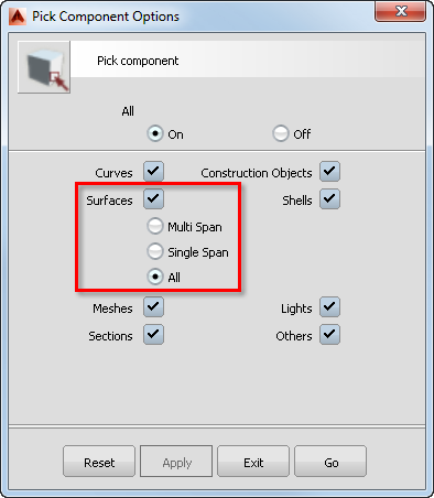

Pick Component can distinguish between NURBS and Bézier surfaces
Pick > Component now shows additional options when Surfaces is checked. You can choose one of: Multi Span, Single Span or All, to select only multi span NURBS surfaces, Bézier surfaces, or both types of surfaces, respectively. The default is All.
