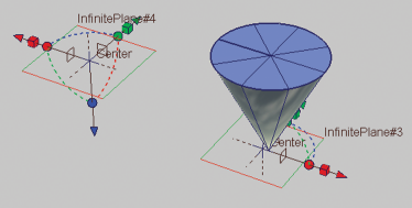

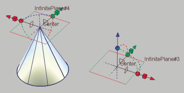

Place Tool: Moving via Planes
TransformObject PlacementPlace works in a similar way to the ICEM moving frame. You can create two planes, one for the from location and one for the to location. This is useful for complex positioning, but for most tasks the pivot point system is easier and quicker to use.
