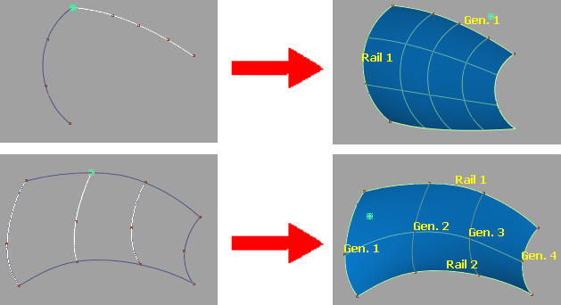

Creates a surface by sweeping one or more profile curves along one or two path curves (rails).
The Rail Surface tool takes its name from its use of one or two “rail” curves. The generation curves maintain contact with the rails at the same points through the sweep, like a train traveling on a track.
The Rail Surface tool is similar to the Extrude tool, but has many more options and much more power.
The appearance of the Rail Surface icon depends on the Generation Curves and Rail Curves settings in the Rail Surface Options window.
Icon
Generation Curves 1 1 2/2+ 2 2+
Rail Curves 1 2 1 2 2

Generation Curves
1 – Sweep one generation curve along the rail curves.
2 – Blend between a start and end generation curve along the rail curves. Use the Gen. Blend Value slider to control the midpoint of the blend.
2+ – Blend between a series of generation curves along the rail curves.
Rail Curves
The number of paths to sweep the generation curve(s) along: either 1 or 2. The default setting is 2.

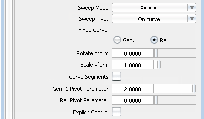

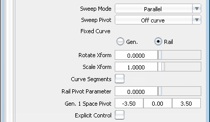

Sweep Pivot
This option is only available when Rail Curves is 1.
Sweeping involves two pivot points:
  • The point on or off the generation curve (the Generation Pivot) that stays on the rail curve as the generation curve sweeps. The generation curve rotates around and scales from this point.
  • The point on the rail curve (the rail pivot) that corresponds to the generation curve before it is swept. In other words, the part of the surface corresponding to this point on the rail curve will have the exact cross section of the generation curve.
You can have Rail Surface set the pivot points automatically (as in Extrude), or set them manually for the generation and rail curves.
Off Curve – Set the pivots to a specific parameter on the rail curve and a 3D point in space for the generation curve.
  • Use the Rail Pivot Parameter slider to set the parameter for the rail curve.
  • Use the Gen. Space Pivot boxes to set the 3D pivot point for the generation curve.
On Curve – Set the pivots to specific parameters on the two curves.
  • Use the Gen. Pivot Parameter and Rail Pivot Parameter sliders to set the parameters for each curve.
Closest – Set the pivots to the closest points on the two curves.
This option is the default. It works best when the generation curve is close to the start or end points of the rail curve.

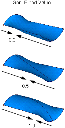

Blend Control
Enable the Gen. Blend Value slider to control the midpoint of the blend between the two generation curves.
This option appears when Generation Curves is 2.
Gen. Blend Value
The percentage of the distance (from 0 to 1) along the rails where the influence of both generation curves is equal.
For example, a value of 0.5 (the default) blends the two curves equally, so that the halfway point of the blend occurs at the midpoint of the rails.
A value of 0.25 places the halfway point of the blend 25% of the distance along the rail curves, hence giving more influence to the second generation curve. Conversely, a value of 0.75 would give more influence to the first generation curve.
The values 0.0 and 1.0 still blend the two curves a minimum amount.

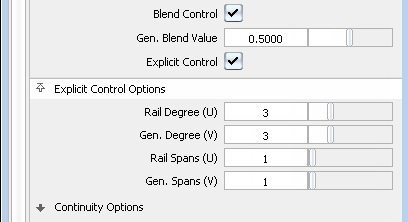

Explicit Control
Turn on this option to open the Explicit Control Options section that allows you to explicitly specify the degree and number of spans of the rail surface in both the U and V direction.
These options are available only when Explicit Control is on.
Rail Degree (U)
Degree of the rail surface in the U direction (along the rail curves).
Gen. Degree (V)
Degree of the rail surface in the V direction (along the generation curves).
Rail Spans (U)
Number of spans of the rail surface in the U direction.
Gen. Spans (V)
Number of spans of the rail surface in the V direction.
