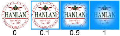

Edge Blend
Controls the sharpness/softness of the edges of the texture. The valid range is 0 to infinity. The slider range is 0 to 1. The default value is 0.
