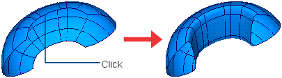

Open or close a surface
  1. Choose Object Edit > Close.
  2. Click a U or V isoparametric curve or edge to open or close the surface across that dimension.
