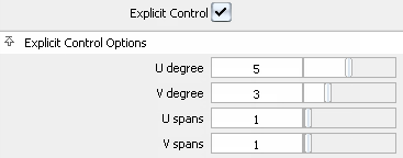

Explicit Control
Many of the tools in Alias have an Explicit Control option, which gives you control over the control point layout in a surface. Keeping the spans at 1 ensures that Bezier geometry is always created.
(In some tools there is a Bezier option, which serves the same purpose.)
