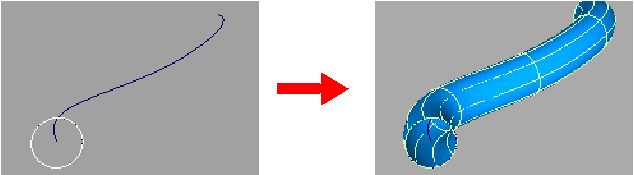

Creates a new surface by extruding a generation curve along a path curve. Normally used to make tubular objects with symmetrical cross sections.

Sweep a profile curve along a path curve
