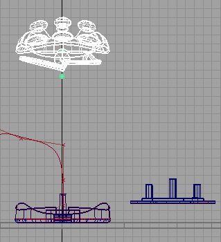

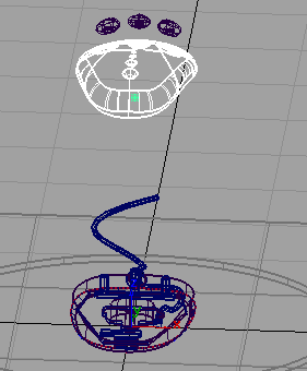

  3. Move the first component of the model you wish to animate well above the model. In our example we are moving the mouse buttons.
    The mouse buttons have been moved above the model.
  4. Deselect all objects.

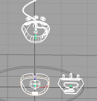

  5. Pick the second component of your model. Here we have chosen the top surface of the mouse.

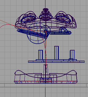

    Drag the right mouse button up to move the top surface well above the rest of the model but just below the mouse buttons.
  6. Deselect all objects.
  7. Repeat the steps 1-5 using a combination of Transform and Rotate functions until you have positioned each of the components of your model.

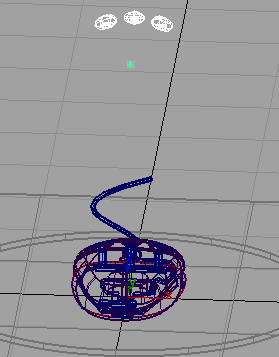

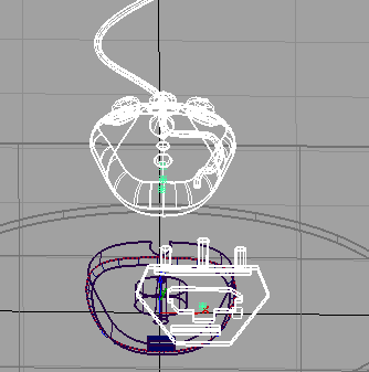

As the model components come together, they intersect each other. In our example, the circuit board is in its final position in the base of the mouse well before the rest of the components come together.
Prevent collisions in your exploded view animation
How to prevents objects in you animation from colliding into each other.

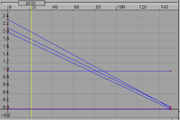

To establish where collisions occur
  1. Click the Scrub Bar and drag the time bar towards the end of the animation to review where the objects are colliding.
  2. Scrub back in your animation to see which objects collide. Pick the object which needs to be changed.

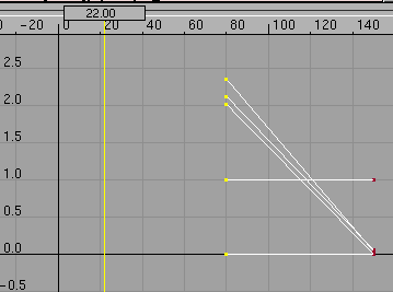

To change keyframes of object to not collide
  1. Open Animation > Editors > Action Window.
  2. In the Action Window, choose Views > Lookat.
  3. Move the selected keyframes to frame to an new keyframe time.
  4. Close the Action Window.
