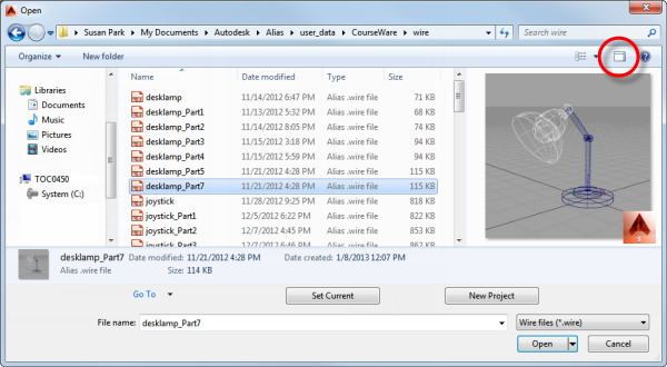

The Windows 7 file browser is now able to display thumbnail images for wire files. This change applies to Windows Explorer, as well as the Windows file browser used in Alias when opening and saving files.
The Windows file browser within Alias has a different look, more in line with Windows 7. Some of the original functionality has been modified:
Current Home – Goes to the folder that is one level up from the current project folder.
Current Project – Goes to the current project folder.
Current Wire – Goes to the wire folder in the current project.
Clicking the Show the preview pane icon at the top of the browser (circled in red in the image) opens a pane displaying a thumbnail of the wire file currently selected.
Thumbnail images are generated within all wire files. The Create .ICON files check box in Preferences > General Preferences now appears only when Type of file browser is set to Alias (old Alias browser) or when running Windows XP, which does not support the new browser thumbnail feature.
If you have Alias installed, Windows Explorer also displays thumbnails for wire files.
