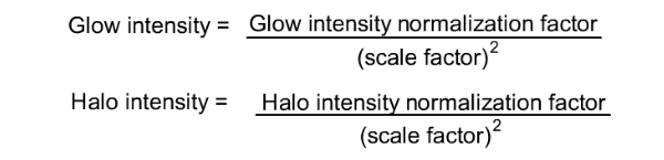

Problem: Shader glow brightness changes during an animation, or Shader glow brightness is different at different rendering resolutions
The shader glow auto exposure is adjusting the overall brightness of the scene for each frame. When a glowing object enters or exits the frame, the glow intensity of all objects changes.
The shader glow auto exposure causes a similar problem when rendering at different resolutions. For example, shader glow brightness is different in a high resolution final render than in a low-resolution test render.
Do one of the following:
See ShaderGlow in Render > Multi-lister
If you are also rendering at different resolutions, you must also scale these values based on the difference in resolutions (scale factor).
For example, if you are doubling the rendering resolution, the scale factor would be 2.
Alternatively, figure out the factor by which the *number* of pixels in the image increases, and multiply the glow by it.
that is: (1920 x 1280) / (720 x 486) = 7.023
Multiply your glow intensity by 7.023
