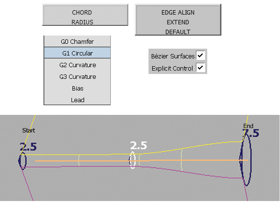

Quality & Profile Options
The Construction Type, Variable Fillets and Section Type options provide the full range of Surface Fillet profiles.
Use the Form Factor, Flow Control options, Explicit Control and Bezier settings to adjust the CV layout.
Tip:
With Variable Fillets, add or remove additional radius values by clicking on the orange edge. Use the middle mouse button to move the radius values along the edge.
