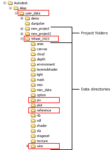

When you first use Alias, a user_data directory is created. This is the recommended location for storing your data, using the project structure described below.
Note:
You can use the browser window to store your data at a different location on your computer or network if required.
