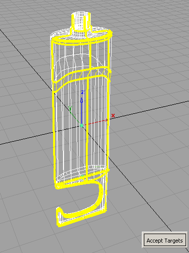

  3. Select all surfaces of the shower gel tube model.
  4. Click Accept Targets to create the lattice.

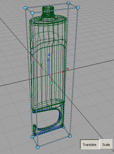

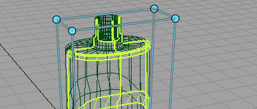

  1. In the Lattice Rig toolbox, click on the Toggle Lattice Engage State tool.
    Notice the lattice is now drawn with solid lines, and the surfaces have a yellow-green highlight.
  2. Use the and click on the four top points of the lattice. Notice that they now have arrow manipulators attached to them.
  3. Click, using the , and drag any one of the blue arrows and move the points upwards.
  4. Release the mouse button. Notice that the shower gel bottle has stretched proportionally.

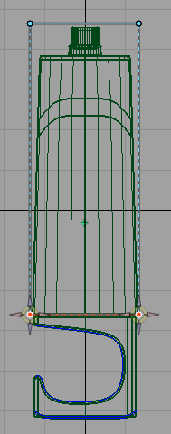

  1. Choose Layouts > Front to switch to the side view.

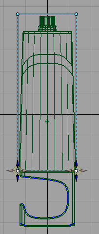

  2. Using the , draw a pick box around the bottom points of the lattice to select them. Notice the arrow manipulators.
  3. Click and drag the blue arrows upwards using the . This moves the bottom of the lattice up. Position the bottom of the lattice just above the point where the hook meets the bottle.
  4. Release the mouse button. Notice that the bottom of the lattice is now drawn in red. This shows that the Lattice Rig understands that part of your target surfaces are outside of the lattice. Target geometry outside of the lattice is never modified (its shape is preserved.)
    The parts of the lattice that intersect with target geometry are locked. When the lattice is engaged, locked points cannot be moved.

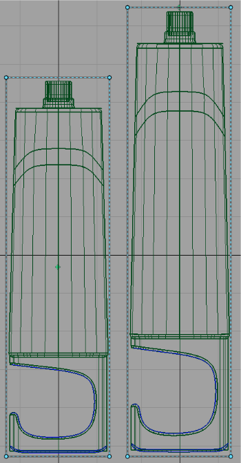

  6. Using the , draw a pick box around the top points of the lattice. Notice that the bottom points are now unselected.
  7. Using the blue arrow manipulators attached to the top points, pull the top of the lattice upwards. Release at the point of your choosing.
  8. Notice that the part of the shower gel bottle within the lattice has stretched according to your change to the lattice, and that the hook outside the lattice retains its original shape.
