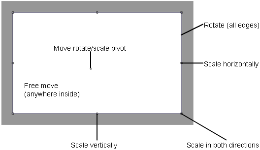

Choosing the tool displays a manipulator on the canvas layer. The manipulator covers the entire layer and lets you apply the transformations as shown in the following illustration.
Note:
To move only horizontally or vertically, hold the key and move the mouse in the desired direction. You can also use the arrow keys to move by small increments.
A context-sensitive cursor shows the current transform mode (move, scale, rotate) as you move the mouse over the manipulator.
The effect of the transformations is shown on the layer as you click and drag on the different handles. However, you must click the Accept button to apply the transformations permanently.
