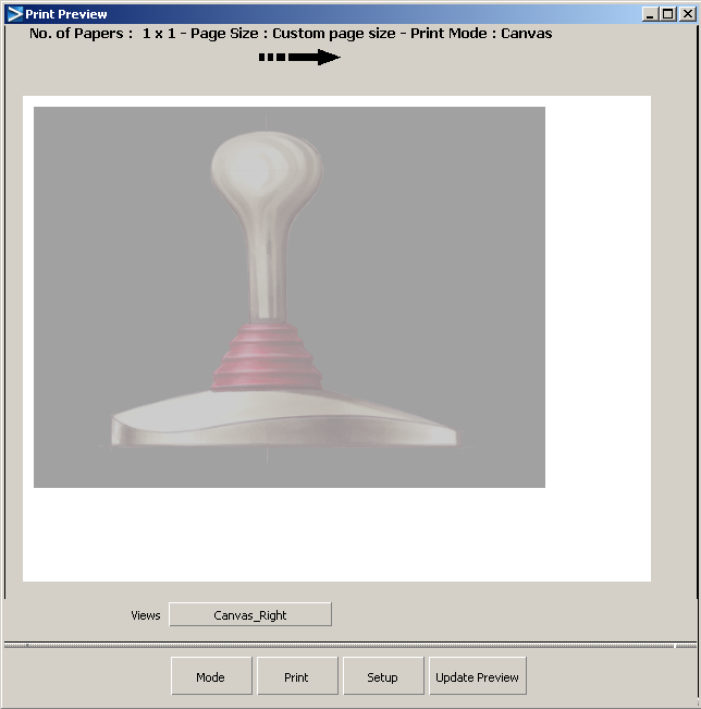

Print Canvas – The current canvas is printed. The Preview area shows the current canvas only. Use the Views lister to select a different canvas to print. Click the Setup button to open the Print Setup window that lets you specify the Image Size and Position. The image will always be adjusted to fit on the page.Only the canvas is printed, without any geometry.

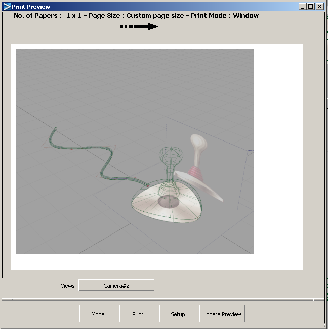

Print Window – The whole content of the window is printed, including shaded geometry and canvas. This is the same content as what gets saved when using File > Export > Current Window. The Preview area shows the active window only. Use the Views lister to select a different window to print. Click the Setup button to open the Print Setup window that lets you specify the Image Size and Position. The image will always be adjusted to fit on the page.

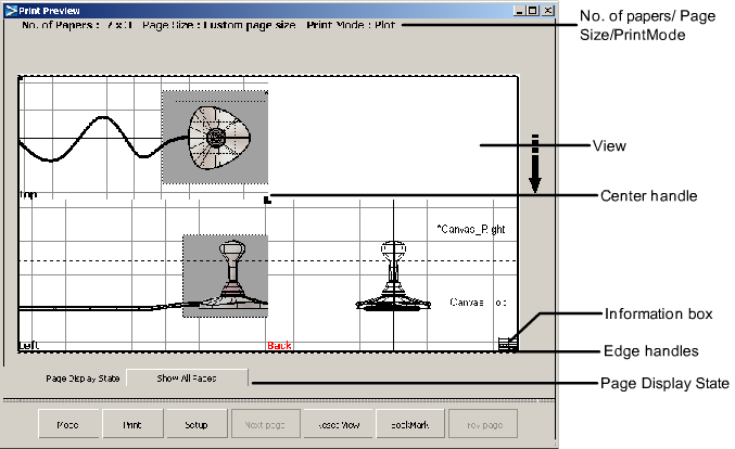

If Mode is set to Plot Print (the default), the Preview area shows the following:
To track around the preview, drag the .
To dolly in and out on the preview, drag the .

No. of papers
Shows the total number of columns and rows of pages in the output.
Page Size
Shows the Paper Size, as selected in the Print Setup window.
Print Mode
Shows the setting of the Mode button, Plot in this case.
Edge handles
Drag these handles to change the size of a row or column of views in the output.
Center handle
Drag this handle to change the relative sizes of views.
View
Move the mouse over a view and hold + (Windows) or + (Mac) to show the view panel, then choose the view direction by clicking an arrow or car icon, or click Perspective.
Information box
Shows the information you enter in the Info tab of the Print Setup window.
Control the display of this box using the settings on the Drawing tab of the Print Setup window.
Page Display menu
Controls how to display a multiple page layout:
Show multiple pages – Show the pages disconnected, allowing you to see exactly what will show up on each page.
Show page by page – Show one page at a time individually. Use the Prev Page and Next Page buttons at the bottom of the window to show different pages.
Show all pages – Show the pages connected, as one large display, with dotted lines showing the page divisions.

If Mode is set to Print Canvas, the Preview area shows the following:
No. of Papers/Page Size/Print Mode
When Print Mode is Print Canvas, No. of Papers is always 1 x 1 (that is, the canvas is printed on a single page), and Page Size is always Custom page size (that is, you can set the size from the Print Setup window).
Views
Choose which canvas will get printed from the list. The content of the canvas appears in the Preview area. If you create a new canvas, it is added to the list.
If Mode is set to Print Window, the Preview area shows the following:
When Print Mode is Print Window, No. of Papers is always 1 x 1 (that is, the content of the window is printed on a single page), and Page Size is always Custom page size (that is, you can set the size from the Print Setup window).
Views
Choose which view will get printed: Top, Left, Back, or Camera (Perspective). The content of the view appears in the Preview area. If you create a new window (for example, Front), it is added to the list.
