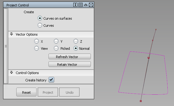

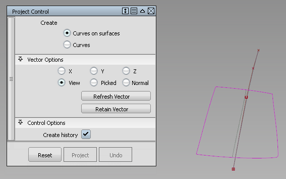

The curve is projected along the View vector of the active window, by default. A curve-on-surface is created on the surface(s).

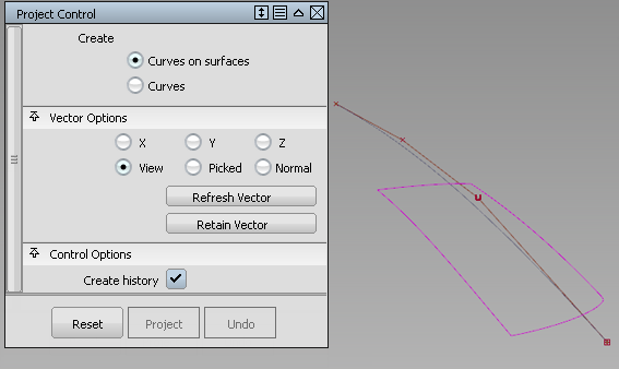

The curve-on-surface updates according to the new view vector in the Perspective window.
The curve-on-surface updates.
The name of the vector appears in the Picked Vector field. The curve-on-surface updates according to the picked projection vector.
