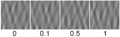

Wave_time
Controls the appearance of the waves over time. If you relate the wave effect to the wake from a boat, the waves start off at some point with a certain velocity and amplitude. This is time zero. As time increases, the waves travel to shore and their appearance changes (their velocity and amplitude decrease). The slider range is 0 to 1. The default value is 0.
To simulate moving water waves, animate the Wave_time value. The waves will move as this value increases. The actual speed of the waves is determined by the Wave_velocity value and the rate at which you animate the Wave_time value.

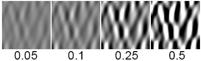

Wave_Amplitude
Scales the height of the waves. The valid range is 0 to infinity. The slider range is 0 to 1. The default value is 0.05.

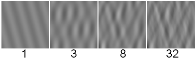

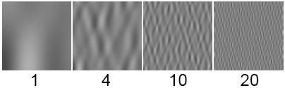

Wave Frequencies
Frequency
Controls the distance between primary waves. The higher the Frequency value, the shorter the distance. The valid range is 0 to infinity. The slider range is 0 to 20. The default value is 4.

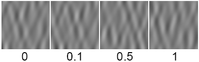

Sub_frequency
Controls the distance between any secondary waves that ride on top of the primary waves (for example, white caps). The valid range is 0 to infinity. The slider range is 0 to 1. The default value is 0.125.

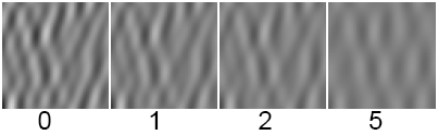

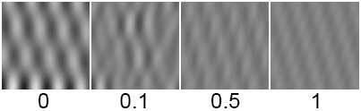

Smoothness
Controls the intensity of any secondary waves. The valid range is 0 to infinity. The slider range is 0 to 5. The default value is 2.

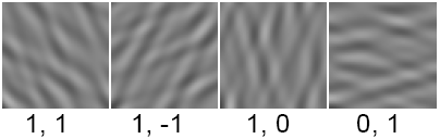

Wind Direction
Wind_u, Wind_v
The strength of wind in the U and V directions (which determines the overall direction of the linear wave pattern). The slider range is -1 to 1. The default value for Wind_u is 1. The default value for Wind_v is 0.

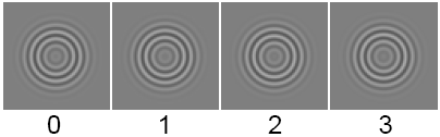

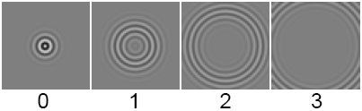

Ripple_time
Controls the appearance of ripples over time. For example, if you relate the ripple effect to that of a water droplet falling into a glass of still water, at time 0 there is no ripple; the droplet has not touched the surface of the water yet. As the time parameter increases to a value greater than 0, the droplet has fallen onto the water surface and the ripple wave effect simulates the effect on the water in the glass at that point in time. When time has reached a value of 1, the effect of the droplet on the water surface is nearly complete and the water in the glass becomes still again.
To simulate moving water ripples, animate the Ripple_time value. The ripples will move as this value increases. The actual speed of the ripples is determined by the Group_velocity value and the rate at which you animate the Ripple_time value.

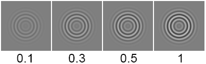

Frequency
Controls the distance between individual ripples. The higher the Frequency value, the shorter the distance. The valid range is 0 to infinity. The slider range is 0 to 20. The default value is 25.

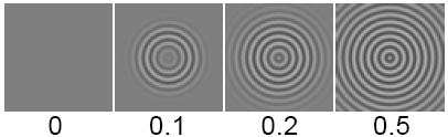

Amplitude
Scales the height of the ripples. The valid range is 0 to infinity. The slider range is 0 to 1. The default value is 0.05.

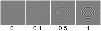

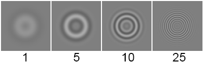

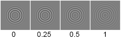

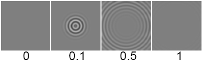

Drop_size
The mass of the droplet that starts the water ripples. (Imagine a water droplet falling into a glass of still water.) A Drop_size value of 0, produces no ripple effect because the droplet has no mass. As the Drop_size value increases, the mass of the drop increases, causing a greater ripple effect on the water surface. The valid range is 0 to infinity. The slider range is 0 to 1. The default value is 0.3.

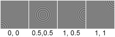

Ripple Center
U_origin,V_origin
The location of the center of the ripples along the U and V parametric directions. The slider range is 0 to 1. The default value is 0.5.

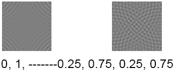

Ripple Reflections
The Ripple Reflections parameters define an imaginary bounding box that ripples can reflect off. This effect, however, is nine times slower than if there is no reflecting bounding box.
Reflect_bound
Activates an imaginary reflective bounding box. The default setting is OFF.
Umin, Umax, Vmin, Vmax
Defines the bounding box in the U and V parametric directions. If Reflect_bound. is OFF, these parameters have no effect. The slider range is 0 to 1. The default value for Umax and Vmax is 1; the default value for Umin and Vmin is 0.

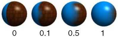

Blend
Gradually blends the texture into the (unmapped) value of the shader parameter being mapped. The blend region is defined by the boundaries of the Texture Placement Object. For example, if a Leather texture is bump mapped onto a surface, and Blend is greater than zero, the bump will gradually diminish as it reaches the boundaries of the Texture Placement Object. If Blend is set to 0, the texture ends abruptly at the boundaries defined by the Texture Placement Object. The slider range is 0 (no blend) to 1 (very gradual blend). The default setting is 0.
Tip:
Blend works best if Wrap is OFF. If Wrap is ON, the texture will blend into the (unmapped) value of the shader parameter being mapped at the boundary of the Texture Placement Object and repeat infinitely as the texture is repeated.

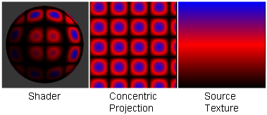

CONCENTRIC Projects a random vertical slice of the texture from the center to the outside edge of each voxel. A voxel is a volume element (a cube). A certain amount of 3D space contains several voxels. The size of individual voxels is based on the size of the Texture Placement Object. A surface that has a CONCENTRIC Projection texture mapped to it appears to be carved out of a three-dimensional array of cubes, where the color of each cube in the array varies from the cube’s center to its edge. For example, try using a Ramp as the Source Texture, and scale the Texture Placement Object very small.
