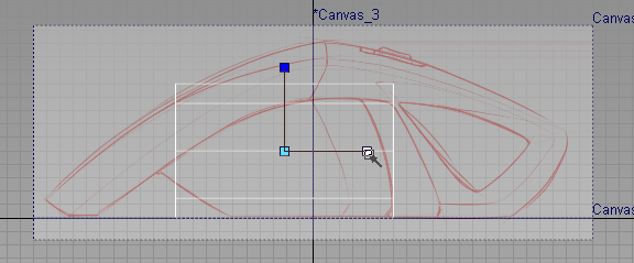

- Click-drag near the center of the Back view. A new cylinder is oriented to this view. You can reposition it as long as the mouse button is held down.
While still dragging the new cylinder around the view, press the
key to snap its centerpoint to the grid. Release the mouse button when the cylinder is near the center of the motor box in the sketch.
The new cylinder remains selected and the creation handles are still displayed. These handles allow easy translation, rotation, and scaling of the new object.
The arrow handles can be clicked and dragged to translate the object. The box handles allow non-proportional scaling. The dotted arcs and the sphere handles allow rotation along each axis.
- In the Left view, use the red (X axis) arrow handle to Translate the cylinder to the center of the motor box area, then use the red box handle to non-proportionally Scale the cylinder along the X axis to match the sketch.

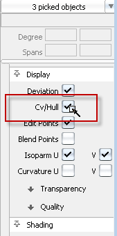

- In the Control Panel, either in the Default or Modeling workflow, expand the Display subsection and check the CV/Hull display on.
The control vertices for the three component surfaces of the cylinder display. The actual CVs are shown as yellow Xs above the surface they affect, with Hull lines shown between consecutive CVs in orange, indicating that the displayed CVs are all selected.
- Pick Nothing to deselect these items, and the CVs and hulls display in dark red.

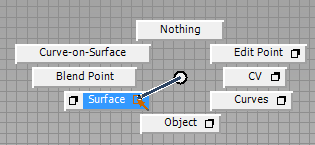

- Bring up the Pick marking menu (
) and choose the Pick Surface tool.
- Pick the body of the cylinder. Notice that the end caps are not selected. The Pick Surface tool in the marking menu is an example of the Pick Component tool with its options modified so that only surfaces can be picked.

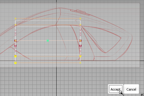

- In the Control Panel, change the numeric value for the Degree in the second entry box (corresponding to the V direction) to 1.
The new parameter is previewed in the workspace windows, where only two rows of CVs are now shown.
- Click Accept in your active viewport to commit the changes to the Cylinder body surface parameters.

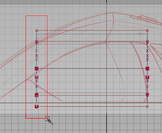

- Pick Nothing to deselect the modified surface, then choose the Pick CV tool.

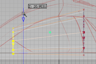

- In the Left view, drag a pick box around the CVs visible on the left side (where the taper should occur).
CVs from both the cylinder body and the cap surface are now picked, which is important to keep the edges of the cap and cylinder body lined up. The Pick CV tool works on all visible CVs in the scene.
- Choose the Scale tool, and in the Left view, click and drag with the
. The selected CVs scale toward the object pivot (the green box currently at the center of the cylinder), and the Cylinder both tapers and becomes shorter.
- While the Scale tool is still active, click and drag in the Left view with the
. This constrains the scale to the X axis, which lengthens the cylinder again, but now we know what the object pivot does.
- Choose the Move tool, and in the Left view, click and drag with the
to constrain the movement to the Y axis, and move down the selected CVs until the surface edge (the white wireframe) rests on the X axis origin line again.

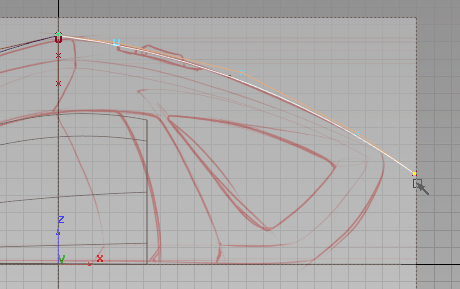

- From the Curves tab of the Palette, choose the New CV Curve tool.
- Click to place 4 new CVs, from left to right, across the top of the sketch close to what is shown in the following image.
When you place the fourth CV, the curve appears in white.
(By default, the New CV curve tool creates degree 3 curves, which require at least 4 CVs to define the shape).
- While the last CV is still selected, choose the Transform CV tool from the bottom of the Control Panel in the Default workspace. This tool allows quick picking and movement of CVs and Hulls in the workspace.
- Click-drag each CV to move them so the curve follows the shape of the top surface and extends beyond the edge of the canvas.
- With the Transform CV tool still active, pick the CV nearest to the middle of the sketch (a red square) and hold down the
key (Windows), or the
(Mac) to snap to the grid, and click-drag with the
to constrain the movement to the Y axis The CV easily snaps to the darker origin line without moving to a grid intersection.

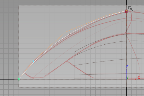

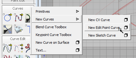

- Right-click on the Curves tab of the tool Palette to show the text menu of curve tools. Choose New Curves
New Edit Point Curve.
You create Edit Point curves by placing points that the curve will pass through. The CVs of the curve are placed automatically, and the curve appears after you place the second edit point.
- Hold the
key and click with the
to grid snap the initial edit point at the front edge.
-click and drag to place the second point along the front edge in the sketch, then hold the
key down to magnet snap the third edit point to the initial CV of the previous curve (represented by a red box).
- Pick Nothing to end curve creation, however the Edit Point Curve tool is still active.
Use this tool persistence to create the back half curve.
- Magnet snap the first point to the top center point of the other curves.
-click and drag two more edit points to the back of the sketch to define the back curve at the top edge.
- Click-drag on the ViewCube to examine your curves in perspective and insure they intersect.

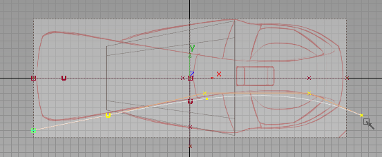

- Switch to the Top view.
- Choose the New CV curve tool.
- Hold down the
(Windows) or
(Mac) key to activate grid snap, and click to place 5 new CVs along the bottom profile in the sketch, as shown in the following image.
- When finished, Pick Nothing to end the curve.
- Pick CV and drag-select the third and fourth CVs.
- Move these two CVs so the curve matches the sketch.
