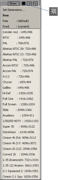

| Lock the size to a preset | Click the size/position icon in the window title bar, and choose a size from the pull-down menu.![]() |
| Lock the current aspect ratio. | Click the size/position icon in the window title bar, and choose fixed: (current).![]() |
| Unlock the aspect ratio | Click the size/position icon in the window title bar, and choose free.![]() |
| Set an exact position and size | Click the size/position icon in the window title bar, and choose Set Dimensions from the menu. Enter the position and size in the option box.![]() |
