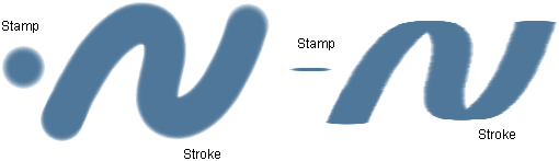

Brushes apply paint to a canvas plane in strokes. A stroke consists of a series of closely spaced stamps. (If you click a brush onto a canvas plane, instead of dragging the stylus, you will apply a single stamp of paint.) You can control how strokes are generated from stamps.

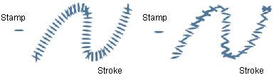

For example, you can control the spacing between stamps in a stroke so they are close or far apart, or so their spacing has an element of randomness.
You can make stamps rotate in the direction of a stroke or always remain in the same direction, or rotate with an element of randomness.
